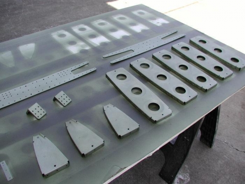

Wiped all the parts with lacquer thinner and PPG DX330 Acryli-Clean and then sprayed them with Sherwin Williams P60G2 Wash Primer. The P60G2 sprays on easy and dries very quickly... nice product to work with.
