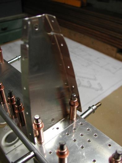

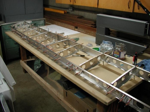

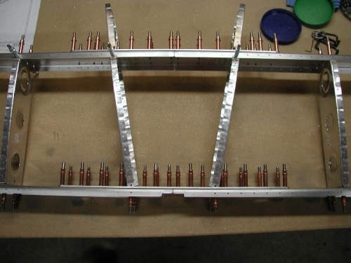

Date:  3-28-2009
Number of Hours:  1.00
Brief Description:  HS Sub-Assembly Work
Finished match drilling the HS-904 main ribs and the HS-905 nose ribs to the spars. Numbered the ribs left and right for reassembly reference. The next step will be to dissasseble the parts, debur and scuff and then set up the HS jig cradle blocks and begin assembling the HS sub-assembly structure inside the HS-901 skins.
