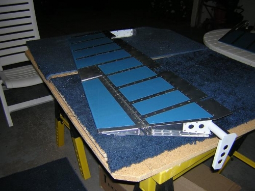

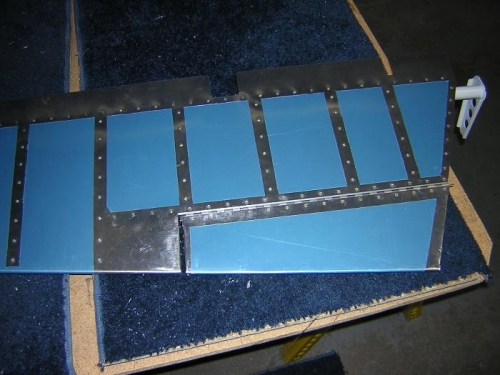

Did everything but rivet on the skins on the right elevator - waiting for the Tech Counselor to visit before completing this assembly.Started the Left Elevator. Bending the tabs on the skins and trim tab are a PAIN. I followed the manual for the skins - my recommendation is to bend the trim tab closure tabs BEFORE bending the TE. I didn't follow the manual's order for the trim tab. I bent the tabs and back riveted the trim tab spar before bending the TT trailing edge. Much better results.Didn't take any pictures until all done.I don't like the skin - trim tab tabs. I will end up using filler to get a better looking end.
Left Elevator & Trim Tab
