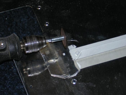

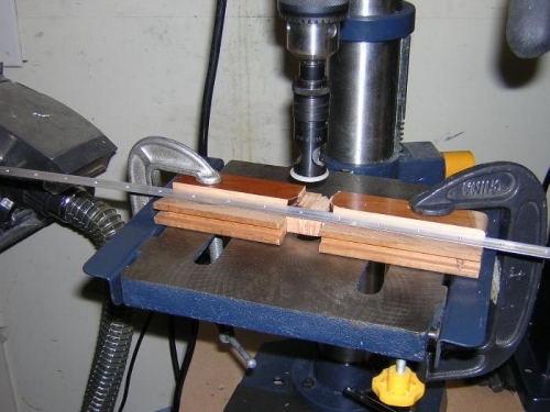

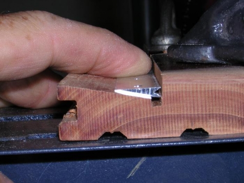

Made a jig to hold the TE wedge for countersinking on the drill press. I have lots of hardwood flooring pieces (from doing our kitchen floor 2 years ago).When I assembled the rudder, the LE of many of the stiffeners interfered with the spar. So I got out the Dremel tool and trimmed them back. I slid a piece of aluminum (a flattened scrap stiffener piece) between the stiffener and skin (bent back the skin just enough to slip it in) to protect the skin.
Csk the rudder TE wedge
TE CSK setup
TE CSK setup
Glueing the TE wedge in place
