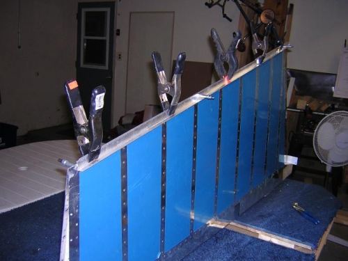

Brief Description:  Riveted rudder - glued TE wedge in place
Build the rudder spar. Assembled the rudder substructure and the skins.I glued the TE wedge in place as suggested in the instructions. I use JB Weld instead of ProSeal (don't have ProSeal and didn't want to wait multiple days for it to cure!). I used a couple of aluminum angles clamped to the TE, plus a few clicos, to keep it straight. Worked great!
Glueing the TE wedge
