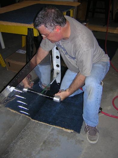

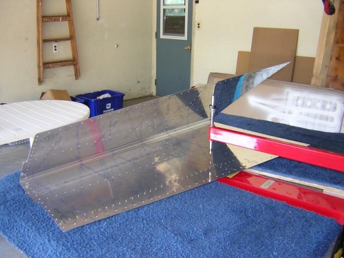

Prepared and riveted the skins on the HS - up to the point of putting on the rear spar. My arms just barely fit to buck the rivets. Secret to good riveting - low pressure on the gun (40 psi) and gentle on the trigger. Had to use the side of the bucking bar - but it worked just fine.
