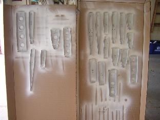

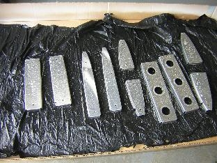

Primed all non-alclad parts
Process: 1) organize parts and note how to identify them 2) clean with MEK (removes all marking) 3) spray with etch/cleaner 4) wash with water 5) dry 6) mark with sharpie 7) prime - 3 light coats
Parts sprayed with etch/cleaner
Mark after cleaning and etching
Primed parts - marking shows through primer
