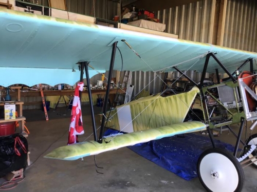

Brief Description:  Reassemble the Air Vehicle

3. Mate the wings to the fuselage.
Status: 80% complete. The wings were reinstalled. It took the majority of the day, about 3 hours. Bolting the struts in place it difficult due to the bolts being recessed inside the wings.
Front Side Wing & Fuselage
Right Side Wings & Fuselage
Left Side Wing & Fuselage
