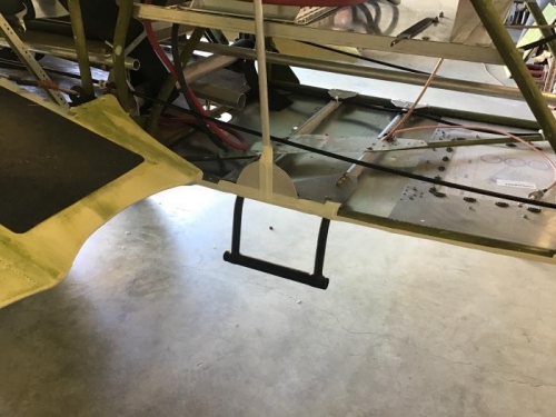

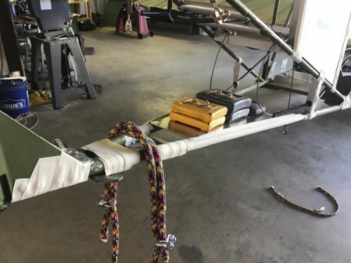

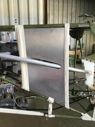

I started today by taping the bottom of the fuselage and cutting a length of fabric to size.
Tail Area Taped
Tail Area Taped
Control Rod AreaTaped
Stirrup Area Taped
Stirrup Area Taped
