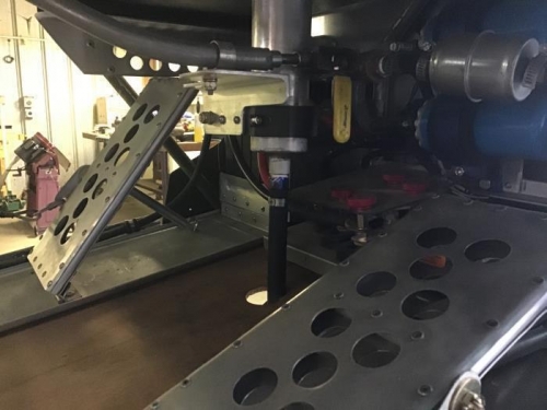

1. Add some additional plate nuts to secure the engine compartment cover.
Status; Complete. The cover puckered at the top rear where there was a gap in the plate nuts. I added one on either side to correct the issue.

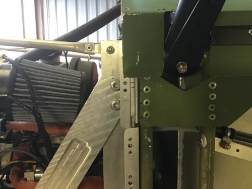

2. Stop some fuel leakage at the sump connector.
Status: Complete. I was smelling some gas at the bottom side of the fuel tank. It appears that the seal for the hose barb was not sealing well. I used Permatex but will switch to Teflon tape. The tape runs the risk of clogging should a stray piece enter the fuel area. I have decided that should a fragment enter the system the filters will not allow it to pass into the engine. It would take a very large piece to create a problem. A leaking barb alternative seems more concerning.

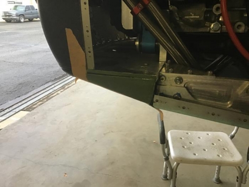

3. Paint the nose tip green.
Status: Complete. Missed a spot earlier. Fixed it today.
Additional Plate Nut (Center in Pic)
Teflon Taped Fuel Barb
Nose Paint Touchup
Nose Paint Touchup
