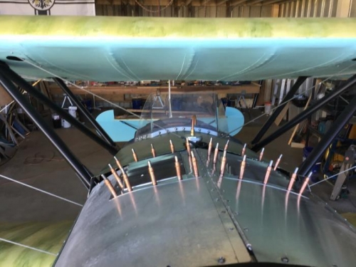

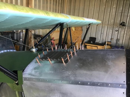

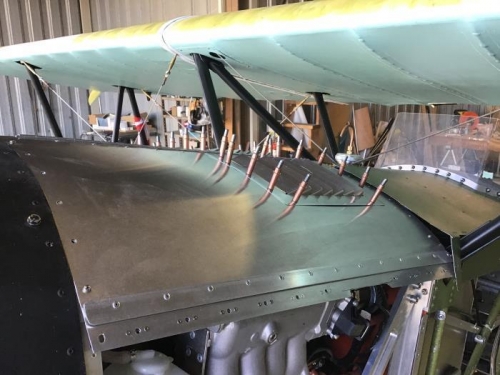

1. Install the louver assemblies into the engine compartment covers.
Status: 90% complete. I have located and cutout the opening for the louvers. Mounting holes have been drilled. Initial test fitting indicates no distortion of the cover occurs when installed. I stopped short of riveting things in place as I want to paint them first.
Right Louver Assembly
Left Louver Assembly
Front View Louvers
Front View Louvers
