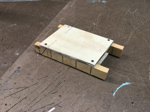

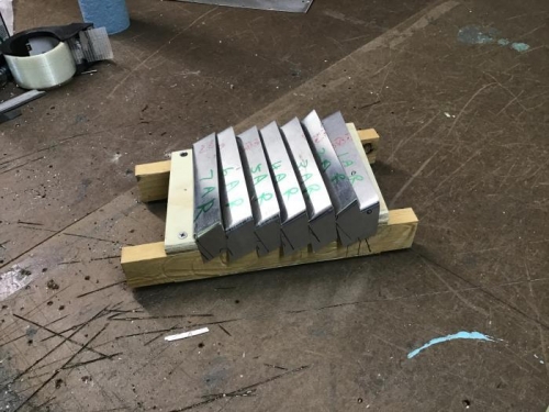

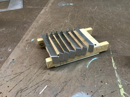

1. Add louvers to the top of the engine compartment covers.
Status: 50% complete. Test runs of the engine with the cover in place were noticeably hotter than those with the cover off. I suspect it is because heat is being generated by the exhaust header and trapped under the cover. To help with this I decided to add louvers to the cover. This is a bit tricky as it involves compound curves and metal working. I felt the simplest solutio n would be to create a seperate louver assembly for each side and drop it into place. The louver blades were completed today.
Louver Forming Jig
Louver Forming Jig
Righ Side Louver Blades
Left Side Louver Blades
