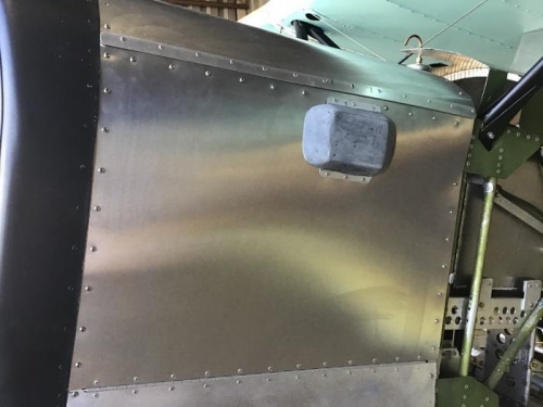

1. Add the TPS cover to the engine compartment door.
Status: Complete. The cover turned out a little oversized. It turns out that the sidewall puckers a bit so the depth of the cover was double that required once installed. I also applied a thin layer of JB-Weld to the external surface of the cover to hide the sharp edges.

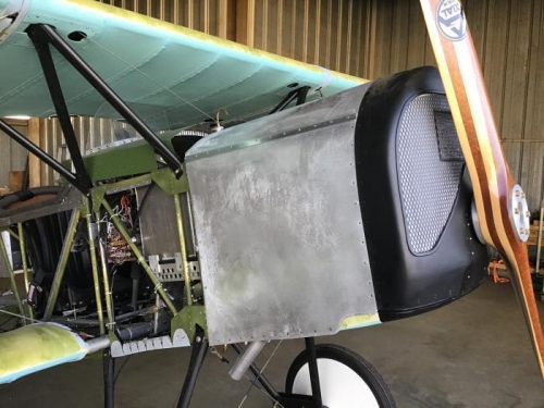

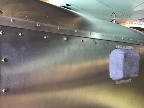

2. Create a clean seam where the doors come together in the engine compartment.
Status: Complete. Simply overlaying the two sheets of AL leaves a bulging joint at the seam. To clean it up I added a stacked ribbon of AL to hide the gap. A similar ribbon was added to the right side for a uniform look. The lower sheet tucks under the stacked ribbon before being screwed in place.
TPS Cover Installed
TPS Cover Installed
Compartment Door Seam
Cosmetic (Matching) Seam on the Right Side
