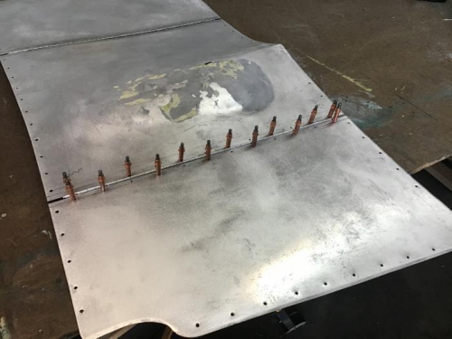

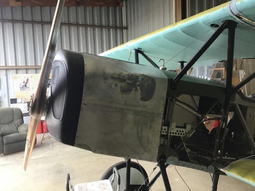

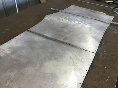

1. Add a hinge to the engine compartment cover.
Status: I have added and removed the engine compartment cover many many times. It is large a bulky and frankly a pain in the ass. I decided it would be far more convenient to add hinges to the cover and simply open the bay using the new door versus removing the cover entirely. I have tried to reuse material at hand to make the changes. Unfortunately I found that the blister for the TPS is creating a problem. The top surface of the cover has flattened. It is being distorted too much to hold the old shape. So the blister needs to go.

Engine Compartment Cover with Top Hinge
Engine Compartment Cover Side Hinge
Engine Compartment Cover Side View
