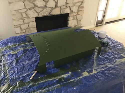

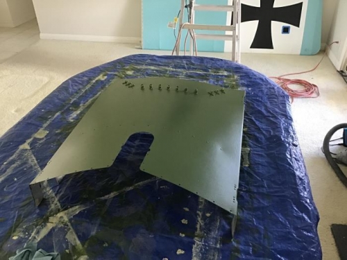

1. Change the fuselage paint scheme to solid green.
Status. 90% complete. The cover for the electric bay was repainted green. I also stripped and cleaned the cover for the engine compartment. I am planning to add a hinge to it shortly so I will hold off painting it for now.

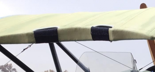

2. Create grips for the center section wing.
Status: Complete. I want to protect the grip area of the center wing from fingerprints etc. I simply wrapped them with paracord.

Electric Bay Cover Side
Electric Bay Cover Front
Center Wing Grips
Center Wing Grips
