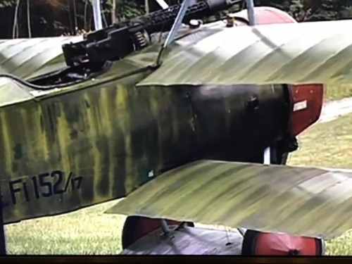

As for paint, I will be using Valspar from Lowes. I have settled on a finish I have not seen in any production DVIIs. It was found primarily on the DRI. It is called the streaky Fokker finish. The photos show an example of what I will be trying to achieve. Unlike other DVIIs the photo also shows a Pattee Cross insignia.
Bottom of wings: Bay Mist 5006-7C
Wings & Fuse: Dark Meadow 6010-5 & Clever Mantis HGSW2224
