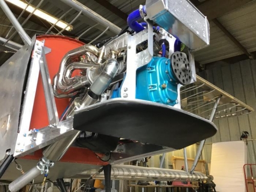

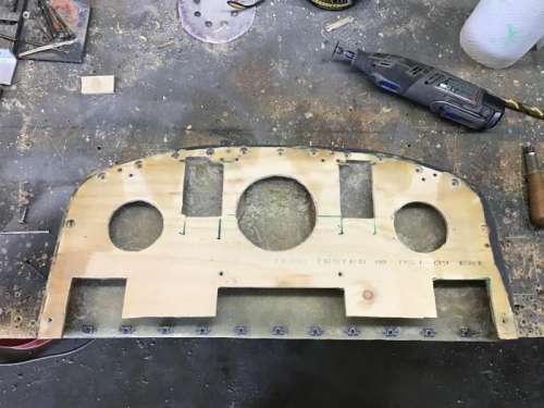

1. Fab the lower cowl bowl.
Status: Complete. A strip of plate nuts were added to the lower cowl after some final shaping.The fiberglass surface was covered with a thin layer of Bondo then sanded smooth. Last, the cowl was primed and painted. It is ready for mating back with the rest of the fuselage.

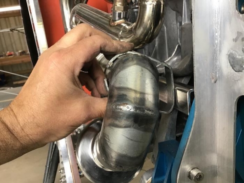

2. Fab a brace for the exhaust bend.
Status. 25% complete. I went back to working the exhaust while the cowl was drying. I am adding a short steel brace between the exhaust bend and the engine bock. I intend to weld it to the bend and bolt it to the block.
