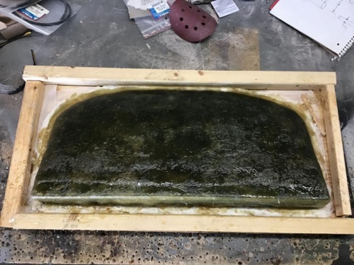

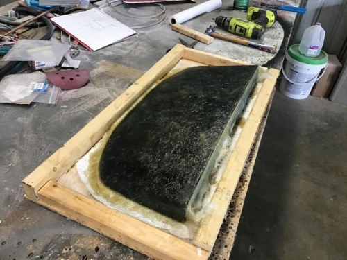

Brief Description:  Lower Cowl Fiberglass Mold
Plans:
1. Fab the lower cowl bowl.
Status: 40% complete. The mold for the cowl was completed. The Bondo version of the cowl was mounted into a frame and outlined with modeling clay to seal the lower edge. Three coats of car paste wax were applied as a release agent. Two layers of fiberglass have been applied and are being left overnight to cure completely.
Mold with First Glass Layer
Second Glass Layer
Second Glass Layer
