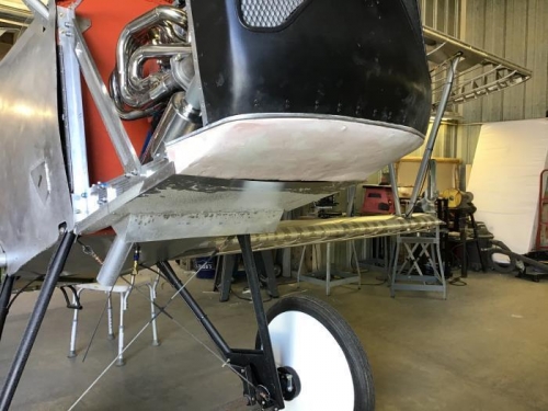

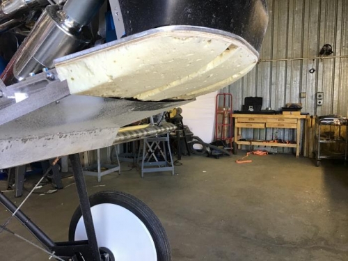

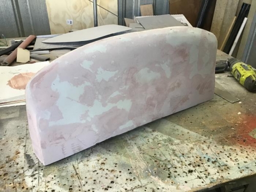

Status: 20% complete. The lower cowl was rough shaped in foam and then sealed in Bondo. The Bondo version was sanded and test fit back into the fuselage. Additional fitting is still required. Following that a fiberglass mold will be constructed.
Lower Cowl in Foam
Lower Cowl in Foam
Lower Cowl Bondo Version
Lower Cowl Test Fit
Lower Cowl Test Fit
