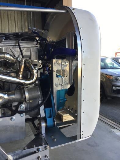

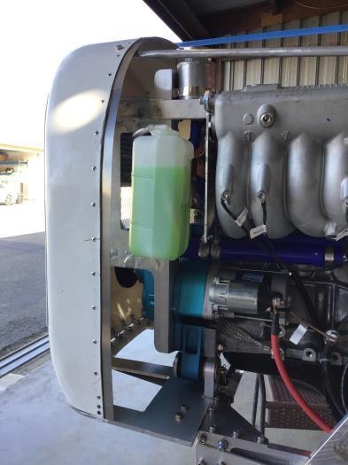

1. Fab engine compartment cowl plate nuts.
Status: The strips that are used for the plate nuts were attached to the cowl. The actual nuts will be placed using the bonnet as a guide. The holes will be match drilled to assure good alignment.

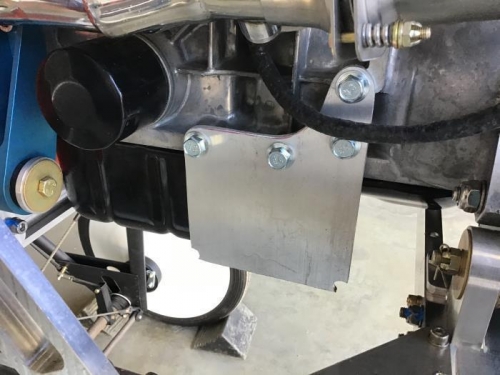

2. Fab the muffler mount.
Status: 30% complete. A 1/4" plate has been added to the engine block. It is very thick to help reduce the muffler's vibration. The muffler will be mated to it with a large band clamp. Aeromomentum has cautioned that the exhaust header will crack if the exhaust is allowed to vibrate.
