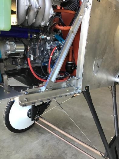

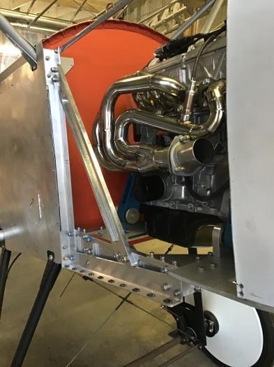

1. Fab the plate nut strips for the lower engine compartment.
Status: Complete. Two strips were fabbed and attached to the engine mount. The strips were placed with the help of a laser level to locate the thru holes and set the angle.

Right Lower Plate Nut Strip
Right Profile
Right Profile
Left Lower Plate Nuts
