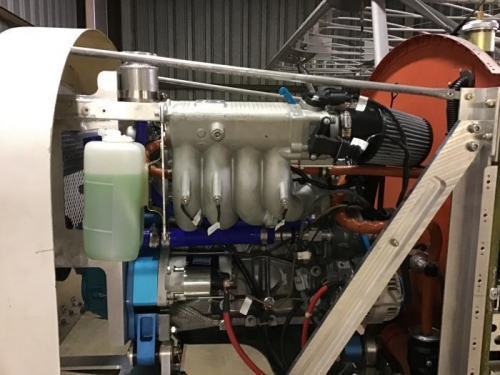

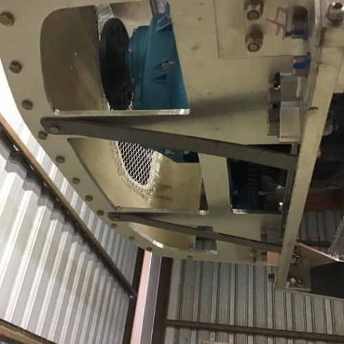

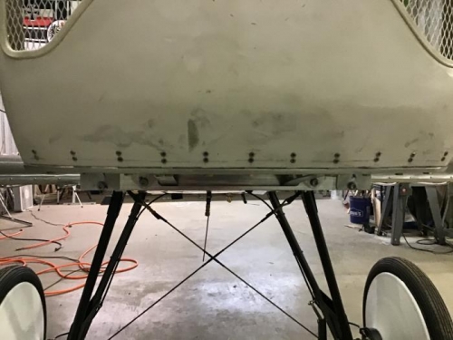

Status: 50% complete. The focus was on three things. The first is to make cutouts in the mounting plate to lighten the weight. Second is to secure the front lower edge of the cowl. Last, spreader bars need to be fabricated and secured at the top edge. The cutouts are complete. The lower edge is riveted in place. The spreader bars as about 25% complete. The lower edge of the cowl is pretty secure while the top relies on spreader bars to hold its position. I'm not sure at the moment how many bars will be required. As it comes together I'll evaluate the need for additional support.
Lower Cowl Connection
Mounting Plate Cutouts
Top Left Spreader Bar
