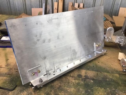

1. Add an extension to the engine mount.
Status: 50% complete. In order to mount the radiator and cowling some sort of mounting surface is required. Since the engine projects out from the mount I decided that an extension to the mount was necessary. A large 1/4" plate was connected by tapping the existing mount and bolting the plate to it. The weight will need to be reduced by drilling holes in sections where possible once it is fitted.
Engine Mount Extension Underside
