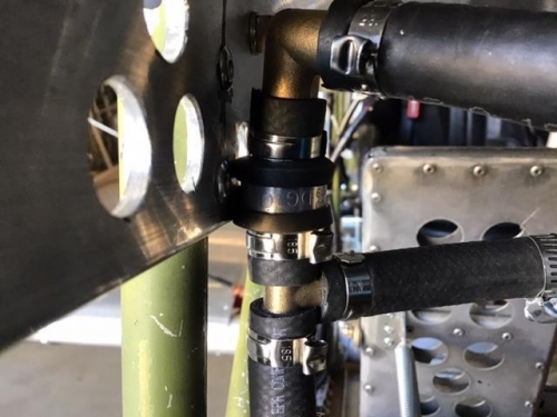

1. Add a clamp to the fuel intake manifold.
Status: Complete. In addition to adding the clamp I removed the fuel filter spring clip and bracket. The clamp alone held the assembly very securely. Between the clamp and bracket a preload was being applied to the fuel tank outlet pipe. Removing the bracket relieved the tension.

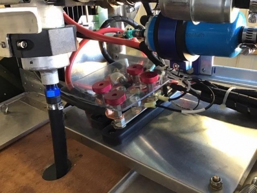

2. Add insulated thumb screws to the power bus covers.
Status: Complete. The bolts that held the power bus cover in place were replaced with non-conductive thumb screws. The buses are now completely shielded from above.

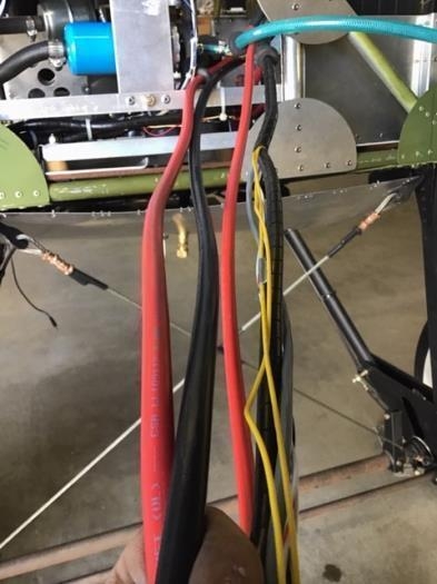

3. Continue wiring the avionics.
Status: 95% complete. All of the electrical leads into the engine compartment were added with one exception. The fuel pressure sensor remains unconnected.
Manifold Support Clamp
Power Bus Protective Cover
Engine Wiring
Engine Wiring
