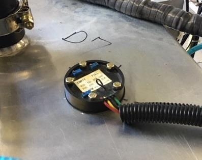

2. Calibrate fuel gauge.
Status: Complete. The fuel sender has potentiometers to calibrate empty and full levels. I set the gauge to read empty with three gallons during level flight. It reads full with ten gallons in level flight. The tank should hold more than ten gallons based on the ad-hoc sight gauge. I heard that 13 gallons is possible when filled to the brim. I chose three gallons for empty because I predict two gallons is not useable. A reading of empty could easily result in the engine stopping depending on the AOA. Full at 10 gallons is easy to remember and do in-flight fuel estimates.

Fuel Gauge Sender
Fuel Gauge Sender

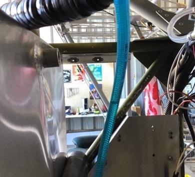

Ad-Hoc Sight Gauge with 10 Gallons
