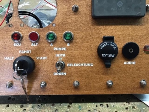

1. Add indicator lights to panel.
Status: Complete. Four indicator lights were added to the panel. Two green LEDs for indicating when the fuel pumps are powered-since it might not be obvious if a pump's circuit breaker has blown or is switched off. These lights will help diagnose the issue. A red LED for the ECU fault status. And last a red incandescent lamp for the alternator status. Not installed is a possible indicator for a low fuel level.

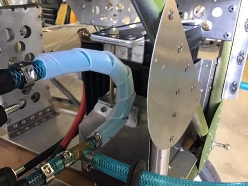

3. Add a fuel line sheeth.
Status: Complete. I found a good solution to providing a guard on the fuel line. I thought of using a section of garden hose but found it difficult to bend with a tight radius. While at the electronics store I happened to see some protective cable sheathing that could easily be added to the fuel line with a much tighter radius. Works great.
