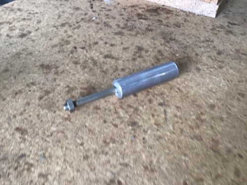

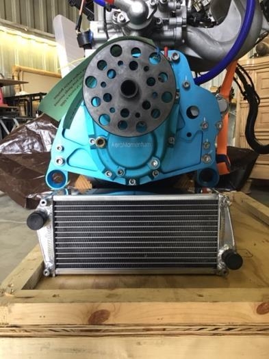

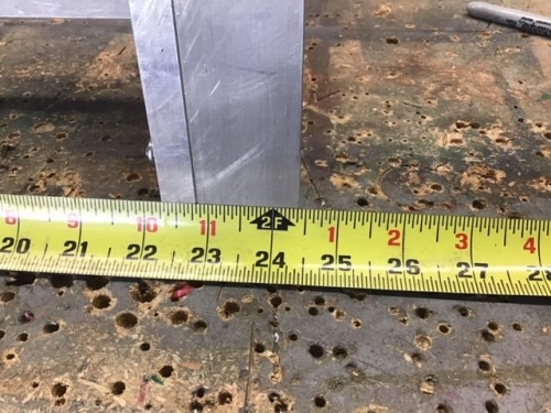

Status. It looks like the width of the mount is about 3/8" too wide. It will need to be trimmed. The radiator will need to have a mount created. Based on initial measurements it will need to be mounted above the reduction drive about 2.5 inches away from the block. Some AL channel should do fine for that purpose. I also built a replacement lug for the mount. The existing lug was installed incorrectlly and damaged during the initial install.
Engine Mount Width
Engine Mount Width
Engine Mount Lug
Engine Mount Lug
Radiator & Engine Face
