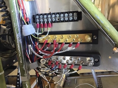

1: Add in-line fuses for the powered instruments and sensors.
Status: Complete. I decided to place individual fuses into the power lines for the instruments. Should any instrument short-out the rest of the instruments on the Avionics bus will continue working. This was actually recommended in several of the instrument hook-up instructions but I didn't have the required fuse holders during the initial install..

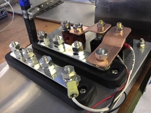

3. Fab and install copper bus bar bridges.
Status: Complete. Inserting the current shunt into the 12VDC battery circuit allows you to get accurate indications of the charging system's performance. It also adds a little complexity. To avoid using bridge wires and crimp terminals I created solid copper bridges to insert the shunt. The copper will provide a very reliable connection that can handle hundreds of Amps. Since the distance between terminals was short this is a simple high quality solution.
Copper Bus Bas Bridges
Junction Panel with Fuses
