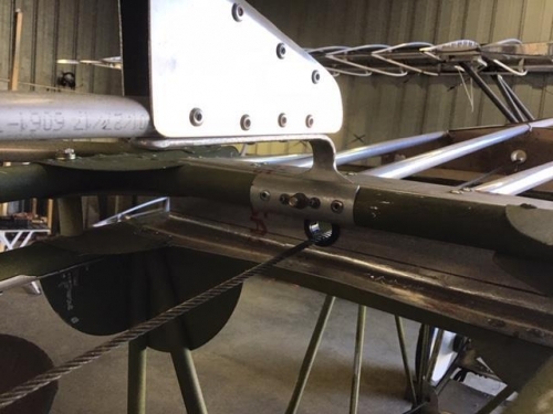

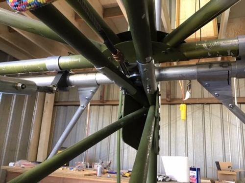

1. Add plate nuts for horizontal & vertical stabilizers.
The connection used to attach the stabilizers to the fuselage require nuts and a buildup of washers if done as designed. Mark Hymer's Fokker was modified to use plate nuts. I liked his idea. The change makes bolting on the stabilizers a snap as you don't need to blindly hold the nuts.
Status: Complete. I fabricated five plate nut assemblies that allow their addition to the fuselage.

Plate Nut Adapters
Plate Nut Adapters
Horizontal Stabilizer Plate Nut Installation
Vertical Stabilizer Plate Nut
