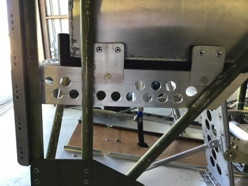

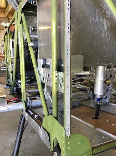

Brief Description:  Fuel Tank Support
Plans:
1. Add tank stays to the fuel tank support.
Status: Complete. A series of rubber bumpers were fabbed and secured around the perimeter of the fuel tank. These "Stays" will act to hold the fuel tank centered in the support platform. Basically all of the degrees of freedom have been locked down. As an additional improvement a series of holes were drilled in the support brackets to eliminate some weight.
Right Fuel Tank Support Stays
Underside View of Fuel Tank Supports
Left Fuel Tank Support Lightening Holes
