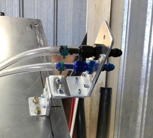

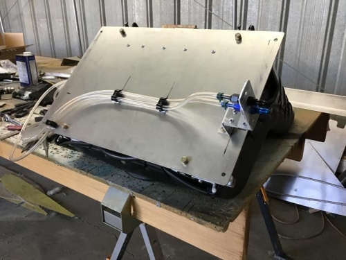

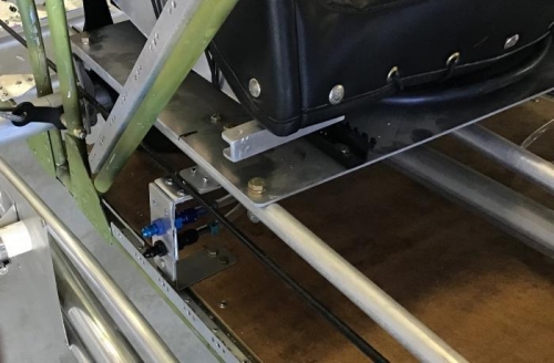

Brief Description:  Pitot & Static Syatem
Plans:
1. Install Pitot & static tubes in fuselage.
Status: 75% Complete. A bulkhead bracket for mounting the tubing connectors was fabricated. Tygon tubing was routed through seperation clamps to the hose barbs. Unfortunately the small hose clamps I used turned out to be the wrong size and must be replaced. The seat has been reinstalled for routing the Tygon tubing into the wing next session. Note that blue and black connector hardware is being used to help identify the function of the seperate lines at a glance.
Under Seat Tube Mounting
Pitot Bulkhead Interface
Installed Pitot and Static Tube Bulkhead Interface
