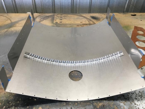

1. Add a support bridge to the bonnet.
When I last had the bonnet on the aircraft I found that the act of securing all the screws contorted its shape slightly. I determined that some stiffening under the hood was in order.
Status: Complete. I added a bridge like member to the underside of the bonnet. It was a 0.032" right angle curved into the same contour as the rest of the bonnet with a crimp tool. Worked perfectly.

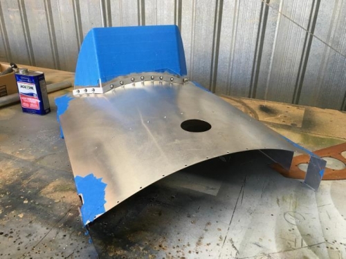

2. Trim windscreen.
After the installation of the center section it was apparent the windscreen was too tall.
Status: Complete. I trimmed about 2.5" off the height and reinstalled the part.
