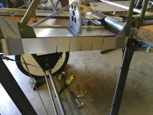

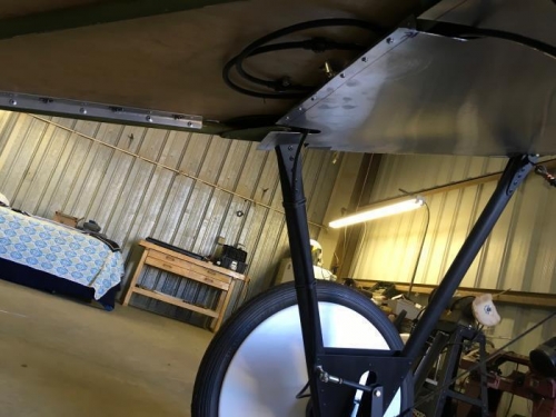

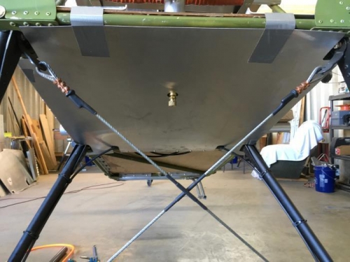

1. Continue fabrication of bottom panel.
Status: About 80% Complete. There were lots of cuts and bends to make. The tricky ones are done. There is some trimming left and I also need to add the radio antenna. You can see some slots cut into the sides. They are required to allow the panel to flex as it follows the contour of the airframe while also leaving a tab to secure it in place. At the moment I am using tape to hold it in position. It will be secured later using the same nut plates as the side panels.
