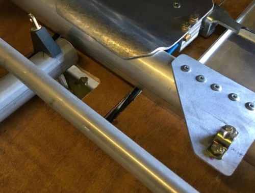

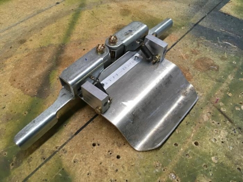

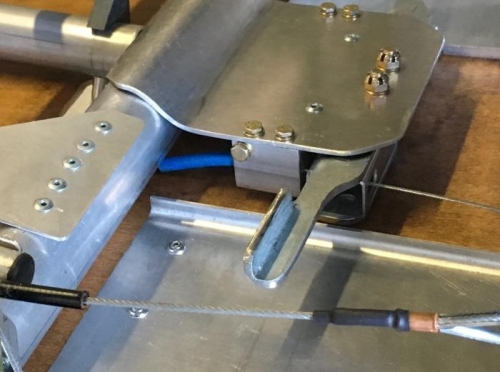

Status: 98% Complete. Just a few loose ends remain. I added custom cable ends and pedal return springs. The cable ends will securely hold the cable housing while allowing the cables to pass. The springs pull the pedals out of the way of the pilots feet when not applied. Now that the assembly is near completion I was able to determine the routing of the brake cables down to the wheels. Some slots were cut into the flooring that allow the cable housings to pass.
Pedal Return Springs
Cable Passage Slot
Cable Passage Slot
Cable Ends
Cable Ends
