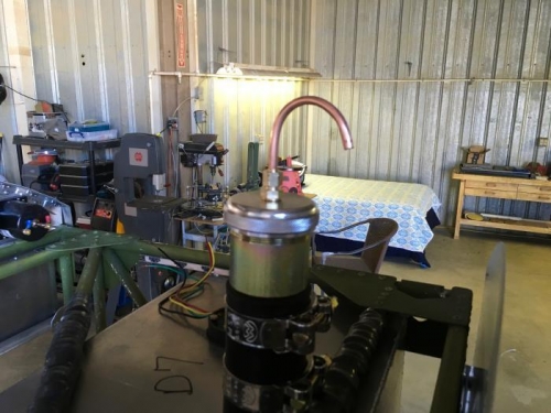

1. Add air inlet to fuel tank cover.
Status: Complete. For fuel to flow freely an air inlet needs to be created in the system. Without the inlet a vacuum will result in the tank. To do this a 1/4 NPT hole was drilled into the fuel cap to allow the addition of a small brass fitting and tube. The tube is curved to prevent water from entering the system.

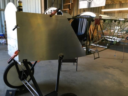

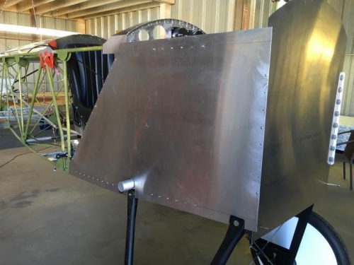

2. Add mounting holes to right panel.
Status: Complete. The holes were match drilled to the nut plates. Now the panel can be installed/removed as needed for future maintenance.
3. Start fab of the left panel.
Status: Started. This panel is a copy of the right panel. The basic outline has been cut. During the next session the mounting holes will be added.
