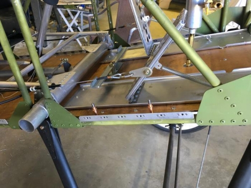

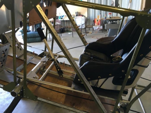

2. Install the plate nut strips.
Status: About half of the strips were installed. These strips provide the means to secure the cockpit side panels to the fuselage.
Left Front Nut Strip
Right Front Nut Strip
Side Nut Strips
Side Nut Strips
