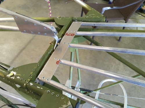

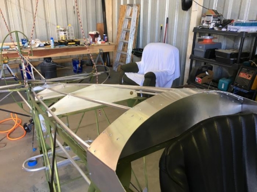

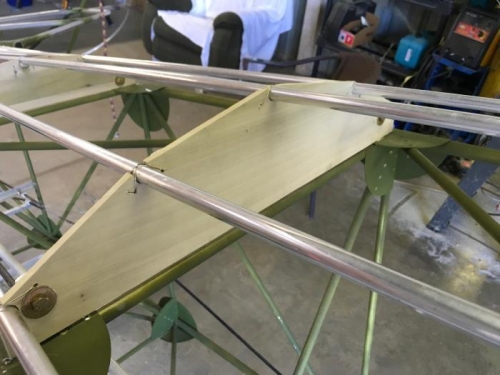

Status: The formers and stringers were cut and secured in place. Getting the correct shape on the formers was more challenging than expected. The one behind the pilot's seat was simply a smaller version of the seat back panel. The rear one however took a bit of shaping while in-place. Eventually with some wood file work it passed the looks-right test.
Rear Turtle Deck
Rear Turtle Deck
Forward Former
Forward Former
Turtle Deck Long Shot
