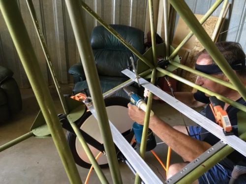

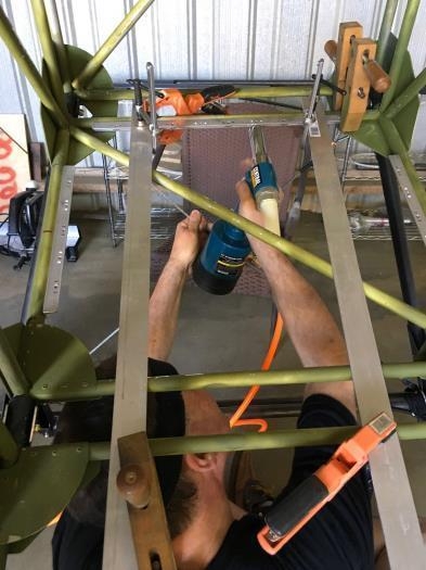

1. Install the floorboard plate nuts.
Status: Complete. Riveted the plate nuts in place. Basically a simple operation of locating the strips using leveling jigs then riveting in place.

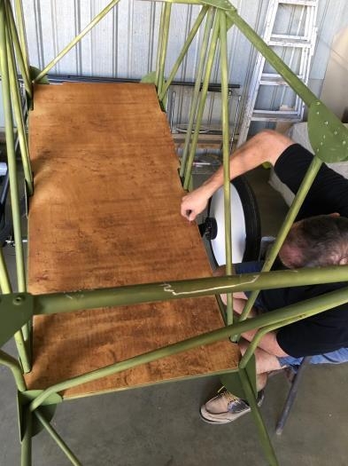

2. Install the floorboard.
Status: Complete. Drilled holes to accept the screws for securing the floorboard.
3. Varnish the floorboard.
Status: 50% complete. Varnished the top side. I will do the bottom side next week.
4. Create trim plates.
Status: 25% complete. To fit the floorboard comfortably some additional clearance was needed near the rib joints. I thought it might look better if the joints were covered with a piece of trim to hide the slop. I need to do this in 4 places. I made two trim plates so far.
Installing Plate Nuts
Mounting Floorboard
Mounting Floorboard
