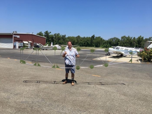

Brief Description:  Finished Left Side
Plans:
1. Complete Left side of fuselage.

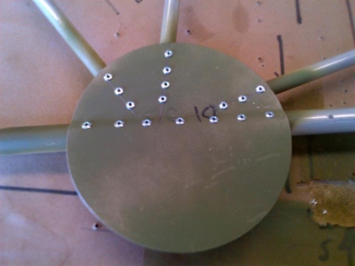

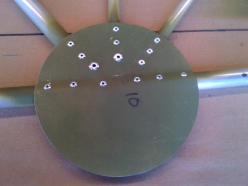

Status: Complete. I finished installing the final gussets on the left side of the fuselage. Just a couple of notes. At station F15 the joint was made using three different tube sizes. This resulted in the gusset not laying down very evenly. I decided to reinforce the joint with a couple of larger rivets to pull the parts a little tighter. I also shifted the gusset at F19 to the rear slightly. It looked like it would allow a better connection to F20 by doing so. I want three or four rivets in every tube. Without the shift I probably would have had room for only two.
Now the bad. I inadvertently riveted the top gusset at F17 backwards. The effect is that I will not have enough gusset to pull around the tube when mating the sides. I will overlay a new gusset on top the first to correct the error. Fortunately it is a hidden joint so it wont show. Replacing it seemed like a bad idea. The resulting joint would probably have been loose.
The good news is that the concerns I had about the "errors" yesterday will not manifest as a problem. I checked Robert's video and he did the same thing. I also checked the fit and it appears there is plenty of wiggle room.
Gussett at F15
Gussett at F15
Gusset at F19
Gusset at F19
Finished Left Side
Finished Left Side
