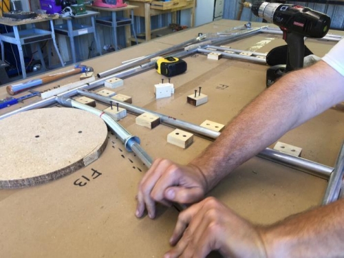

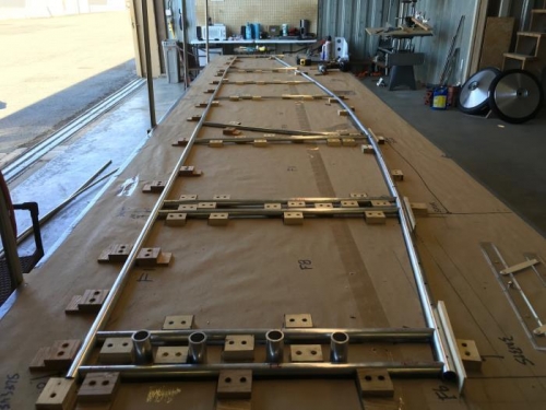

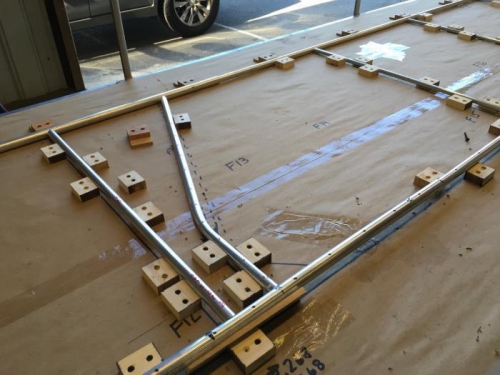

1. Continue cutting a shaping ribs.
Status: Completed about 10 ribs.
Rib at Station F13 added a new twist. Namely in addition to coping the ends it needs a bend. To bend it I mounted a bending jig on the table. I also used a tube bending coil to prevent a kink. Only one problem today. I managed to cut F13 short. I junked it and made a new one from another tube. That leaves me a tube short for F11. Easy enough to buy so all-in-all a good day.
