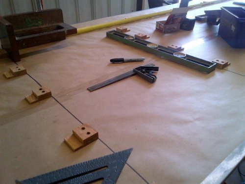

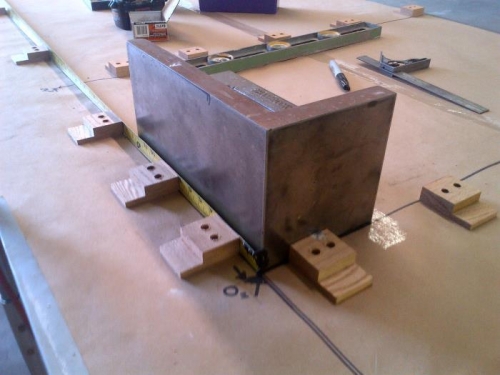

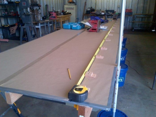

Brief Description:  Loft Fuselage Left Side
Plans: Loft Fuselage Side
Status: Started. This seemingly simple task. Copying the drawing of the fuselage onto the work top is challenging. It is important to maintain angles and dimensions throughout. A great deal of care was taken to draw a perfectly straight line to use as a reference for all other dimensions. I completed the first two stations and the top longeron by securing locating blocks. The AL tubes are held in position by the blocks to ensure they are located and held exactly while being riveted.
