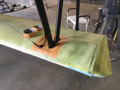

Status: 75% complete. Plates for the left upper and lower wings have been tailored. The blue paint was again peeled off by masking tape. All the plates will need to be repainted. The rear-most plate on the upper wing needed slit in half to be installed. Trying to thread two struts, and two cables proved too difficult. I have re-joined the halves with a screw to restore the strength.
I also installed the upper forward plate of the right side.
Masking Tape Template and Blank Plate

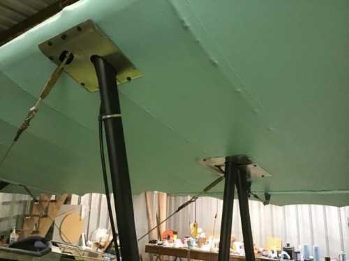

Finished Left Lower Wing Trim Plate

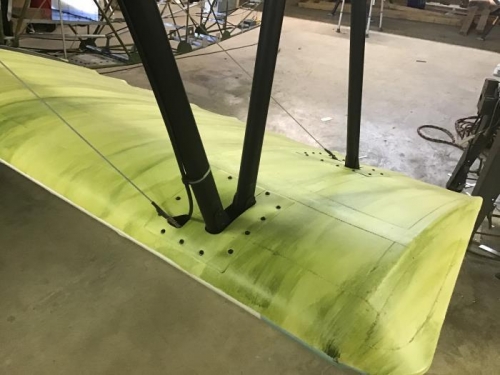

Left Upper Wing Trim Plates
