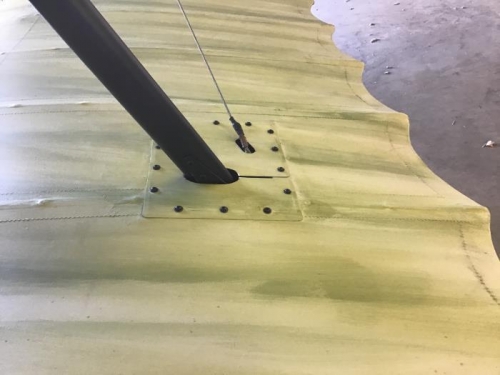

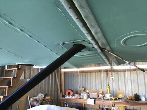

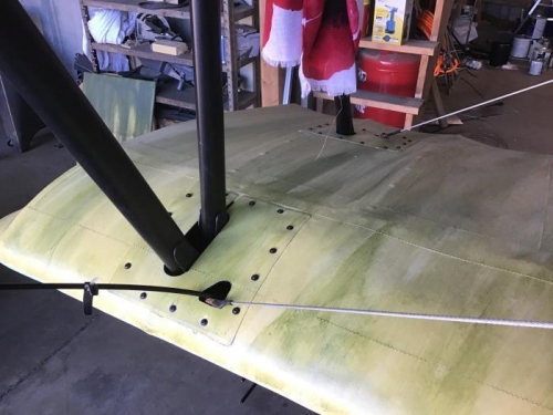

Status: 50% complete. Since I was unable to progress on the fabric I recalled the trim plates were available to install. The plates first need to be tailored to fit around the N struts. The process is simple. I overlay the openings with masking tape narrowly around the struts etc. creating a hole template. Using the screw holes as registration marks you transfer the template to the cover plate. The hole template describes the areas to be cut with a Dremel tool.
Right Lower Wing Trim Plates
Left Center Section Trim Plate
Left Lower Wing Trim Plate
