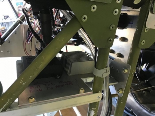

1. Upgrade to a 6 Amp DC-to-DC converter for the Comm and Transponder.
Status: 80% complete. The earlier converter was good for 3 Amps max. I was running the radio and cigarette lighter outlet with it exclusively. I decided I should move the transponder & GPS input power to the converter as well. This was primarily to protect the very expensive electronics in the event the alternator might fail catastrophically. Not quite done hooking things up yet but the system is in place.

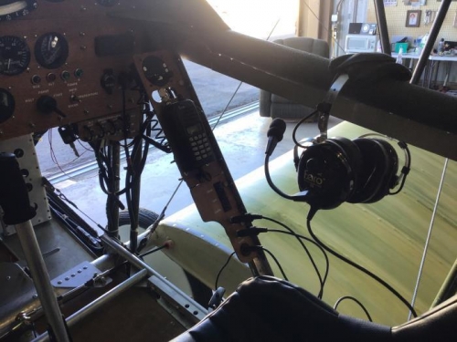

3. Install the circuit breaker/headset board.
Status: Complete. I hooked up the microphone plug, reinstalled and tested the systems. All good.
Improved DC-to-DC Converter

Headset Jacks Installed
