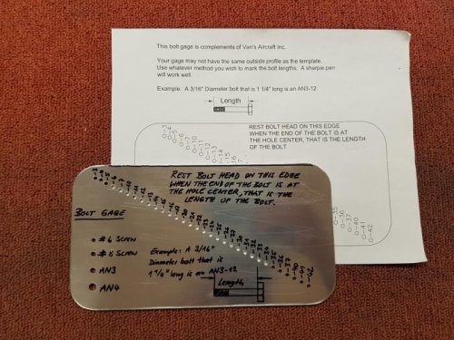

Deburred and edge finished the BOLT GAGE tool from
Just a quick drawing with the sharpie to have this nice tool ready when needed.
