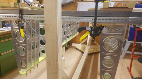

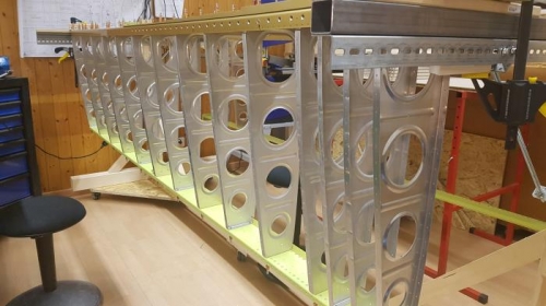

Brief Description:  rear rips
I fluted and straightened all rear rips and clecoed them on the L/R spars. I still need to deburr all edges and pilot holes. This will take forever! I like the look on the wings on the jig. I realize how big this project is. I created an adjustable mid-spar-support. This is really useful, since the spar bends down in the spars middle section.
