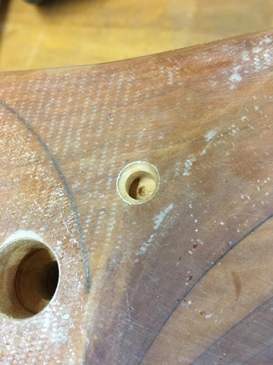

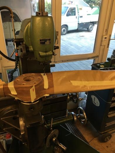

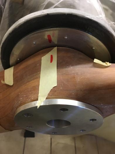

Had to drill two holes to the back side of the prop to match the rivets from the spinner bulkhead, Afterwards, the prop was prepaired for the final PU layer with the spraying gun.
