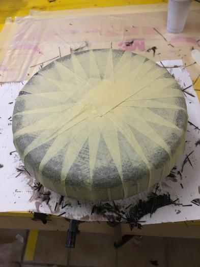

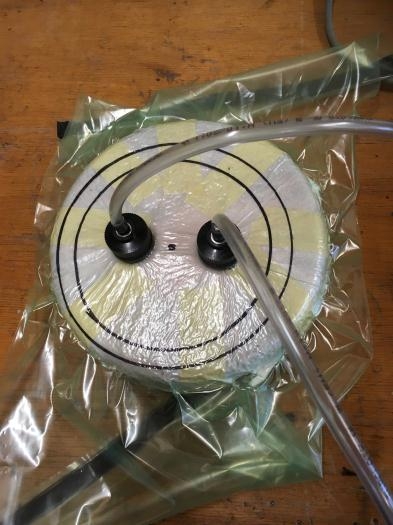

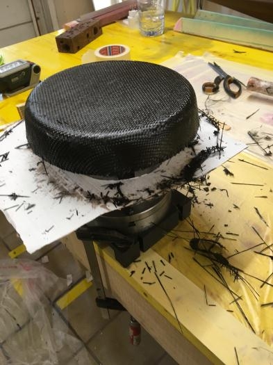

6 layers of 285g ATLAS carbon fiber was applied and prepaired for the vacuum process.
The 6 layers were, as already with the rear bulkhead, applied with 60 dregrees of speperation to each other.
