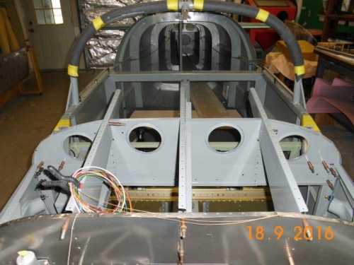

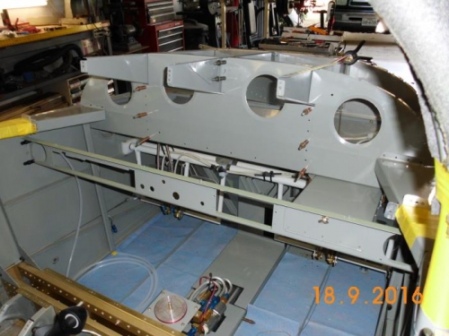

I wanted to open up the sub-panel for access later in the building and maintenance process. Installed 4" lightening holes with 1/2"flanges for strength replacement.
4" Lightening Holes
Front View
Lower Panel and Sub-Panel
