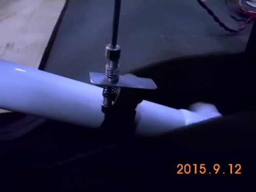

I choose to install the POS-12 Sensor in the center console just above my Flap Posistioning unit.
Image 3 shows how I installed the push rod to provide approximately 1/4" of sring loaded travel in either direction before exceeding the limits of the sensor.
Flap Positioning Sonsor
Flap Positioning Sonsor Push Rod
